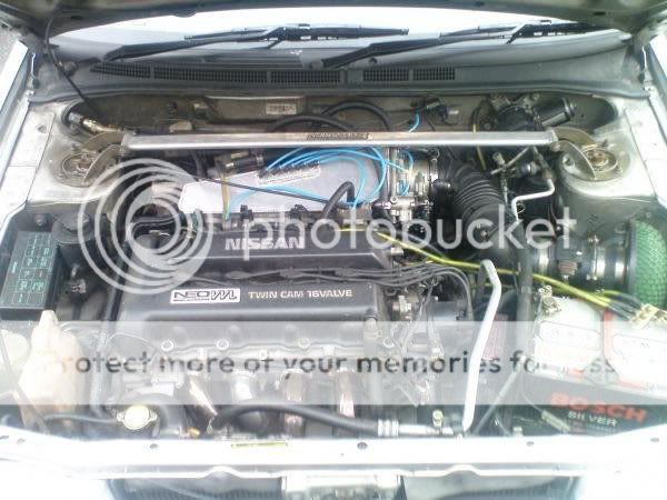

Like to start a discussion on custom intake manifold for n/a and turbo engines. Anyone like to start ? I have tested 3 diff cars with custom intake manifold and they responds differently. Some better pickup respond, some slower pickup but huge improvement on the mid n top end especially for turbo cars.
example of a custom intake manifold
pic is borrowed, owned by nchun1 (monster sr20ve):adore:
both na and turbo also uses custom intake manifold for improve engine respond. u like to share you're using one too ? :)

nonono, is not mine, is my friend nchun1. i think he is a zth member here too. i was asking is there also anyone using this kind of setup. normally this custom manifold gives about 10% extra engine respond n some extra horses.....
