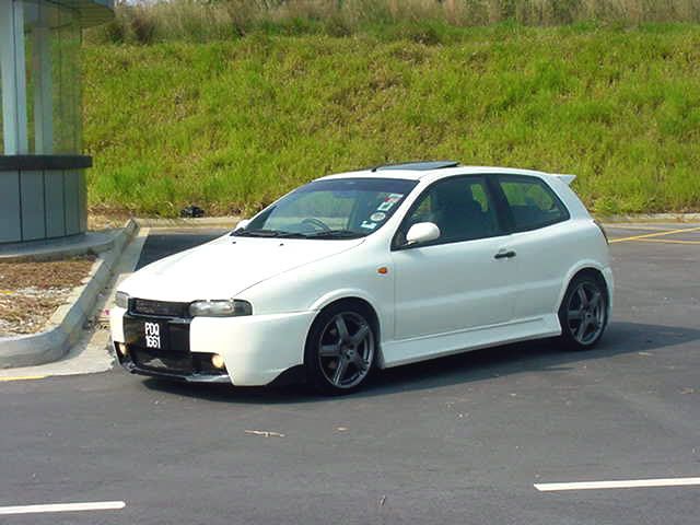

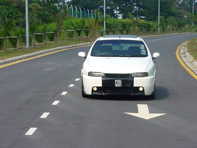

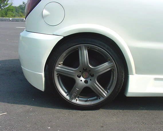

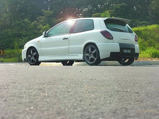

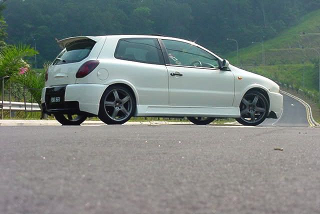

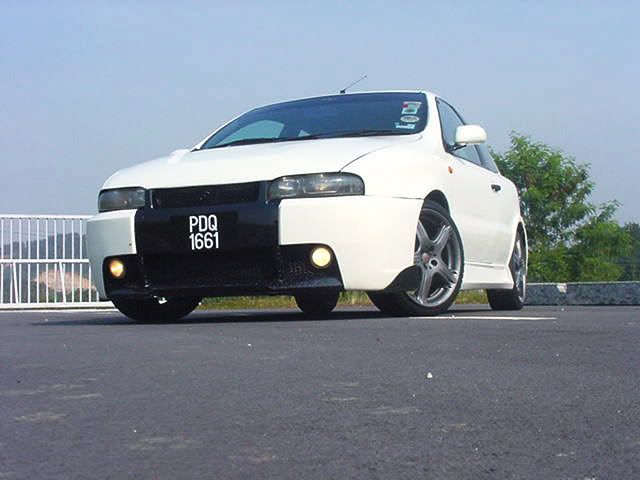

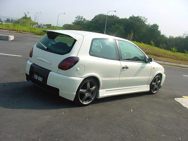

hey apexc, nice rims you got there. i still love the Volcane series especially the 2.0 16V hehe. a real redlining machine. and that 17inch MAK Torque is good la. anyway, i drive an old car a bro. not as nice as Citroen hehe. anyway, check out my babe here hehe. it's bound to be sold soon hehe.
haiya. that is not an old car.. but anew refresh car... nice rim and bodykit... why want to let go.. looking for powerful machine?? :lol:
haiyaaa, already 8 years of age la bro hehe. why wanna let go? hehe, my monthly installment is killing me. 2 years back, it was ok, but now since i have a house, a land and also a rented apartment, haha mati la. to refinance would simply mean to restart all over, would be a waste of time. but somehow, the maintenance of my Bravo is not high la, just scheduled services. anyway, i am looking to get an Alfa Romeo 155 which i am gonna turn into a DTM monster hehe. hopefully hehe.
