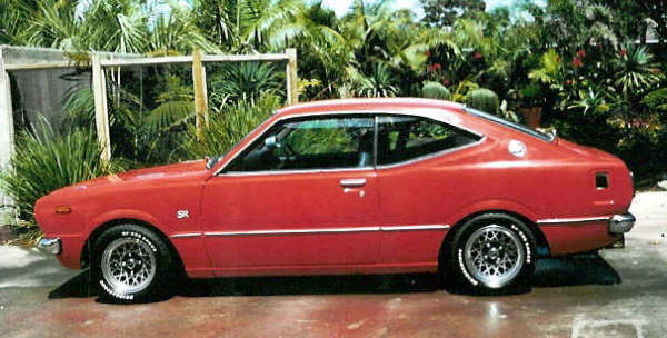

sth like this old school rims may be?
index.php
