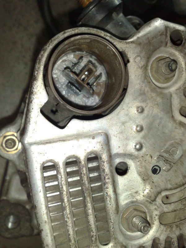

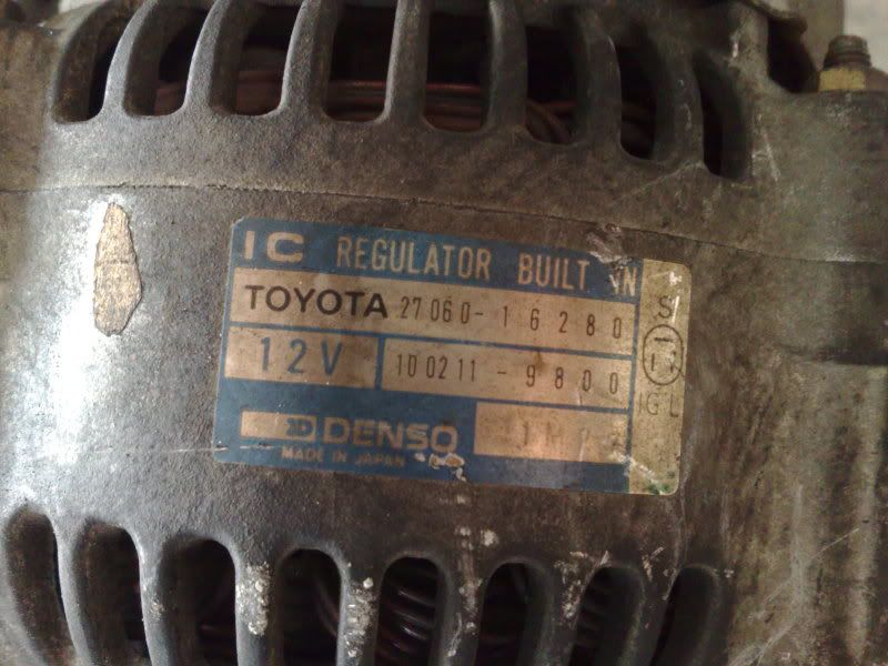

still using it until now. dunno exact model...got at chop shop, they said its from camry 2.2 yr 96, the socket is same... 1st week use the cable burn, fix it then kautim.
t-la, you tha man la!! thanks bro! everything is working fine..all lights are brighter, idling better, a/c more powerful, etc...

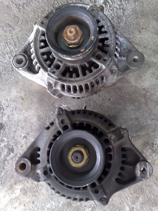

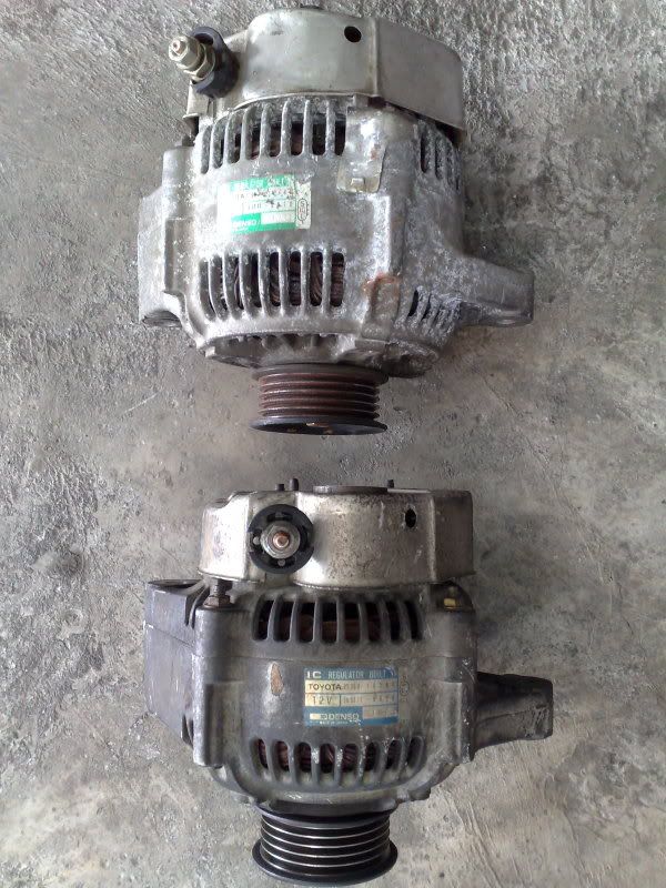

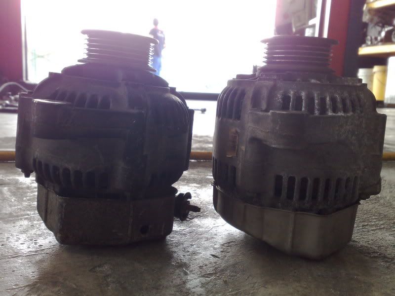

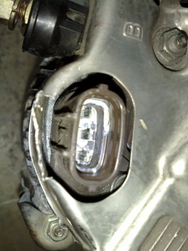

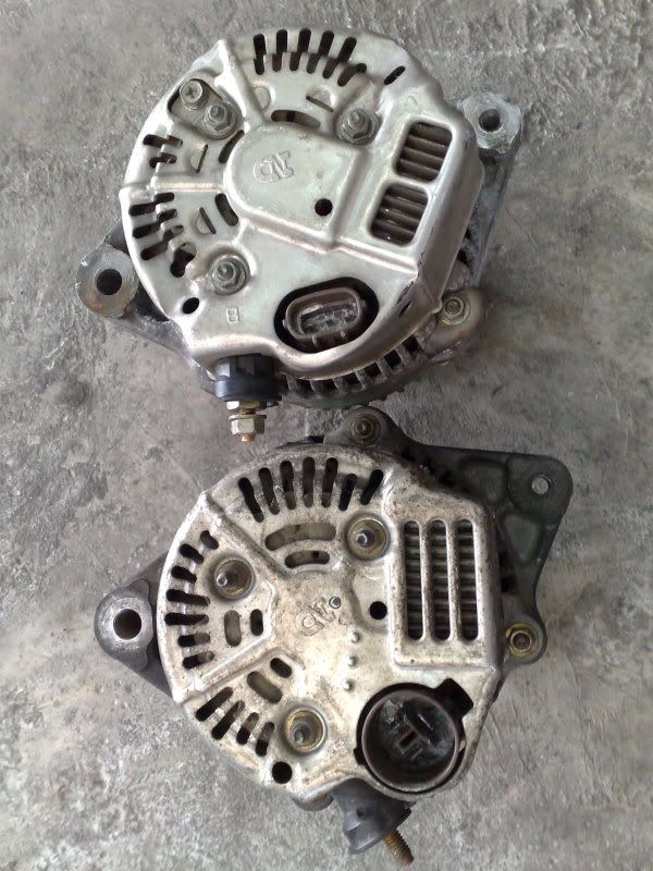

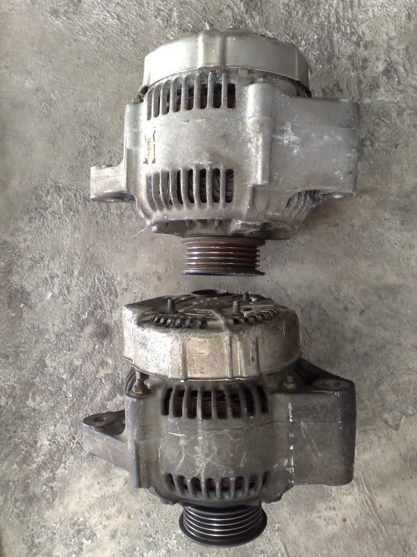

bought it during the weekend and installed it. it's from a 5S-FE 2.2 engine.. it's a direct fit and I learnt that it's a bitch to take out an alternator from a AE101 20v! They should have just put it on top of the compressor like the 4afe and the 5S engines!!! hehe..

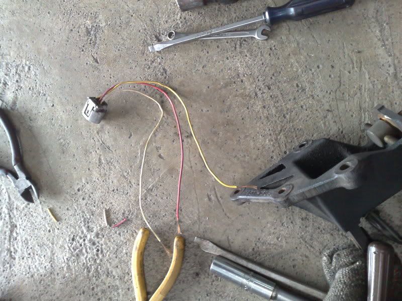

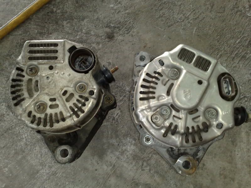

anyway, no mod done but the socket was different..it's just a matter of joining the old wires to the new socket..very straight forward coz the colour of the wires are the same. See pics la..

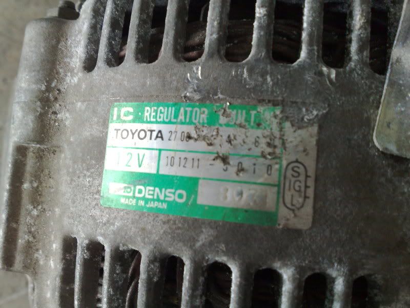

The one with the blue tab is from the 4age svt (70amp)..green tab from the 5S (80apm)

but what's important is having the same fit alternator..that you'd have to try or maybe you can measure it before going to the chop shop.. your's should be easy to measure as it sits in front of the engine..
