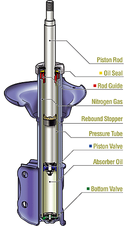

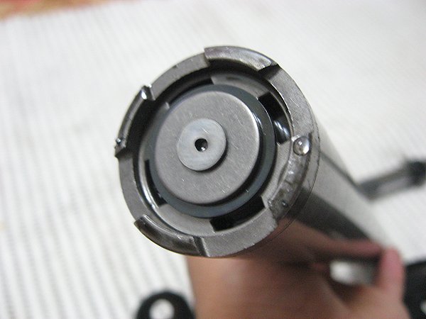

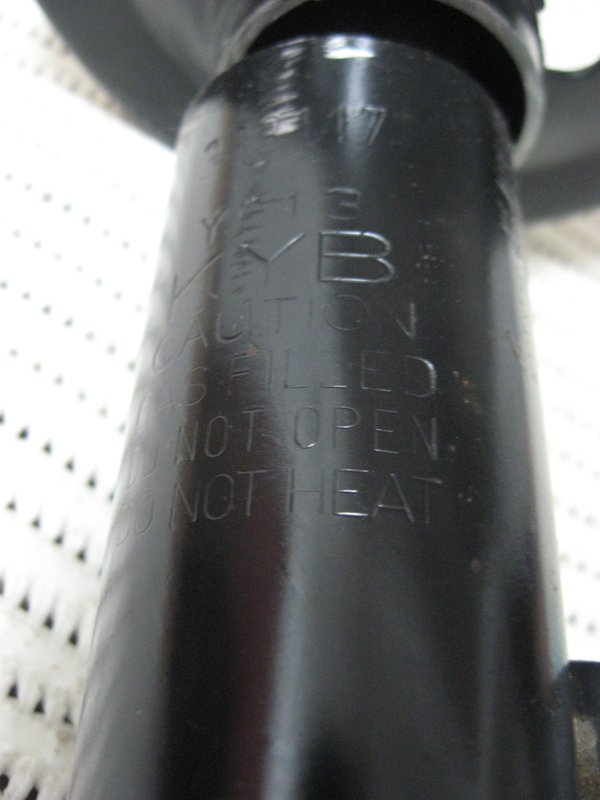

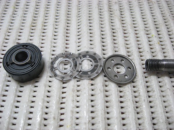

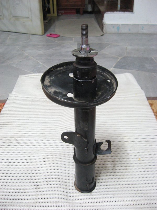

Hi guys, this evening just only 1st day fasting but I already gone crazy. I took a risk to take apart shock absorber to just take a look what inside.
Here is few picture of Kayaba Rear gas absorber previously use at my ride

They have a machine to test the damping rate of your abs therefore can tune it to the spec that you require.
They have different grade of materials (valve, oil seal, shaft etc) for different budget/market. If you are looking for something good and long lasting please ask for "export quality".

Kimi, I believe your soft/hard absorber is using weld to secure the oil seal, which is why they have to fabricate a top cap onto the absorber inserts (cartridge) so that they can replace the oil seal and screw the cap back into place. IMO, i don't think its reasonable to repair a soft/hard absorber coz for the total cost, you can get another set of absorbers with some spare cash as well.
Usually this method is recommended for coilover setup. Just my 2cents....
